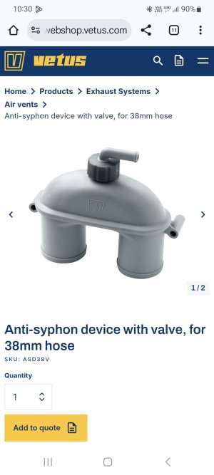

I noticed a leak from the sea water cooling discharge area on my boat yesterday. I assumed it was just one of the hoses needed tightening but the area is inaccessible to my old bones. My mechanic came today and said the leak is from the anti syphon. Apparently there's a tiny joker valve thingy inside which is not doing its job. He says the valve is not available separately and I need to buy the whole unit (see pic) - €160 here in Türkiye.
Does anyone know of a source for the valves?Screenshot_20250714_103053_Chrome.jpg

I realise that but the actual breather valve looks to be the same part as yours so you could by the complete unit and swap the valves or by the valve spare parts kit but it's the similar price to the complete unit.
Thanks again. I understand now. I'll order a set and check because I'm sure I'll need them again. I've actually ordered the complete unit from a chandlery in Cork as my wife's niece is coming out this weekend. The supplier I found in Türkiye has no stock.
