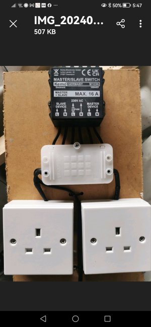

17 Jul 2024 #1 PabloPicasso Well-known member Joined 12 Feb 2010 Messages 2,314 Visit site Is it possible to get a switch that will turn on my vacuum/dust extractor when I start my table saw, and switch it off after its stopped. All on 240v in my garage.

22 Jul 2024 #2 Bodach na mara Well-known member Joined 21 Aug 2002 Messages 2,594 Location Western Scotland Visit site I don't know if this is possible as an after purchase acquisition. Some models of workshop vacuums have it built-in. You plug the vacuum into a power socket and plug the tool into a socket on the vacuum.

25 Jul 2024 #3 PabloPicasso Well-known member Joined 12 Feb 2010 Messages 2,314 Visit site Yes, possible. This is my new set-uo with a master slave switch, thanks to advice on the PBO forum
