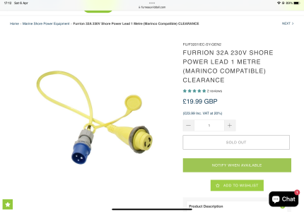

I am after some 2.5mm2 UV resistant yellow Arctic cable for a replacement 16A shore power lead. Plenty of suppliers online but I a want one that will will resist fading and doesn’t cost an arm and a leg. Any suggestions?
Yes, I think that typically 240v is blue and yellow 110v but it doesn’t seem that is is strictly adhered to, even by the suppliers.When I got a reel of arctic cable, I've a vague memory of the yellow not being recommended for 240v as it's what's used on 110v kit in the UK. I can't remember if the guy actually refused to sell me it, but I came away with blue.
