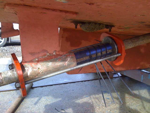

Did my cutlass bearings last week with a Strut Pro tool.
Wow, what a pleasure!! Job was done without removing shafts in about ten minutes per side (not including taking off props and removing grub screws).
Tool was about $500 incl delivery and tax from the U.S. - shame I couldn't find a distributer in the UK..
This may sound expensive, but after getting quotes from local marinas its paid for itself already.
No connection, just a very satisfied customer
