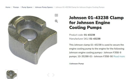

Replacing the water pump on a Kubota D722 (Our Beta 20, your Nanni N3.21) is absolutely not difficult: The sensible option would be to get one delivered pronto and swap it over - no precarious alternatives or whatever.
The University of Youtube will show you how to do it - most engines are pretty much the same ( loosen alternator, remove belt, undo probably two bolts that hold the pump on with little clampy things, see pic (probably one of them is a bit awkward to get to), put new pump in. redo clampy things, put belt back on (maybe replace as well for good measure) and tension. Job done. Cup of tea time :-)
Othere info that may be of interest:
IIRC pumps like the Johnson F4B & Jabsco equivalents run at around 40 lpm
FWIW in our Centaur (ca 3.5t) we got towed across a (millpond) Solent by a mini tonner with a 2.2 Merc!

ASAP do a parts ID service - free. And Marine Service Kits are pretty clued up IME. On our old MD2B, the pump seals didn't match the normal ones, but they got there after I sent photos. The whole pump should be easier as there are only two critical buts: the flange mount type/size and the shaft drive style (some shafts have a tab that goes into a fork in the engine side and others it's vice versa - easy to see the difference).
I'm not sure if the clamp on flanges are engine specific, but again should be easy enough.
