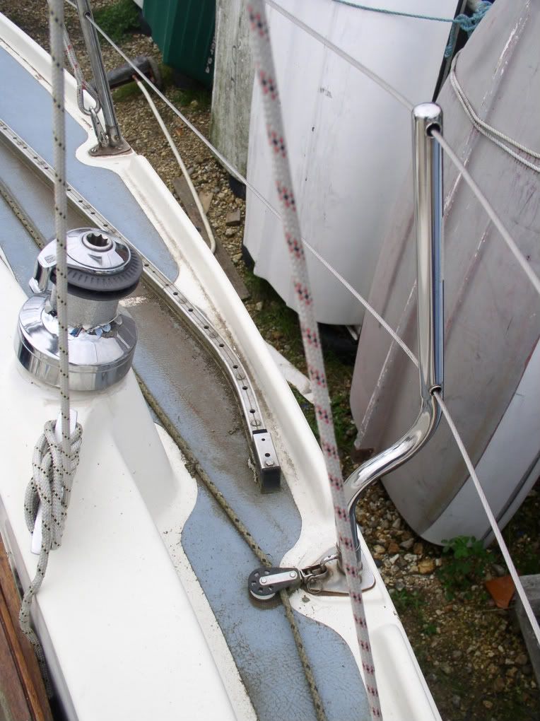

Does anyone know where I can get a 6" winch handle? :o
I know you're joking, but a shorter handle will leave you with a lower ratio than the Gibbs you replaced. I had a similar problem with the main winches - skinning my knuckles on the stanchions when grinding hard, which is best done by getting your chest right over the drum and winding 360 deg. I saw a great idea on a refurbished Co32, the offending stanchions were replaced with ones offset by a couple of inches by bending them through two right angles directly above the base. It's not a cheap option as bending thick walled stainless tube is not easy and then the guard wire holes need to be made at the right height, so you can't just bend the existing ones!
