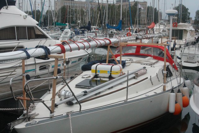

+1. I recall reading an article by someone who almost lost their mast over the side on the Gironde. They returned and bought heavier supports and more lashings. Our mast never touched the lock wall, even in the round locks of the Midi. As in my photo, we left an overhang of about two metres astern but very little ahead.

Vyv - the photo gives us a great idea of what we should be thinking of doing.

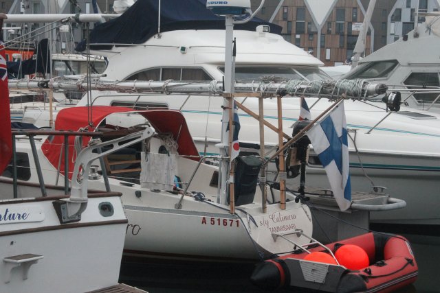

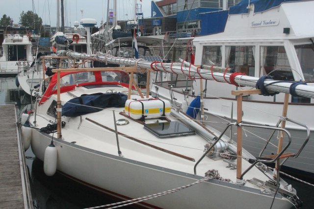

Another example. Next time I would add an additional T support at the stern. Worth thoroughly planning the whole set up BEFORE you leave the UK. Make all the frames - you can always cut bits off to get the right levels. The cargo straps are essential and easy to keep tight - ropes - they're for sailors!
