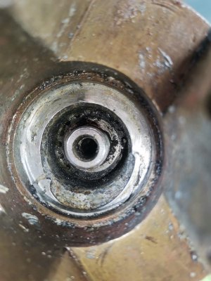

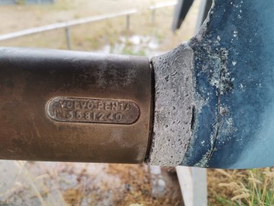

Hi. Seeing that the anode (and part of the sail drive) is shot, I thought I'd remove the anode, which depends on me removing the propeller it seems.
The anode nor the propeller has any screws visible from outside, apart from the 3 allens that I removed when removing the blades.
So far I removed the 3 blades, and the central screw of the propeller.
However, it won't slide off. I noticed a crescent-shaped washer/locker inside, I think that's what holding it in place. How can I remove that?
Many thanks, -t

Normally to remove a prop from its shaft you can put tension on the prop with a pully extractor and then give the prop a hit with a hammer and the prop should release

Unfortunately this thing is a bit different -- the locking thing after the nut ("b") was missing.
I ordered a puller from Amazon and will struggle once it gets here. Thanks!
Have a look at the epic KevinV posted as it looks like a socket screw locking the ut in place with a special shaped locking washer.
Remove the locking screw before sing the puller/hammer

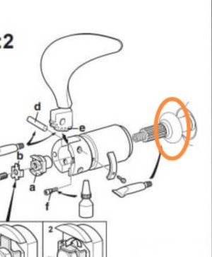

Maybe the spacer has been crushed in a bit by whomever put the prop on last time. Maybe the part circled here?

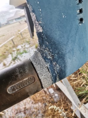

what you see in the middle is the end of the splined prop shaft. There is no other locking mechanism. The reason why you can't get it off easily is probably because the splines were not greased and it is just stuck. hopefully your puller will get it off OK, although not sure how you are going to use a puller. You might try 2 levers between the hub and the anode. the anode is held onto the drive by 2 set screws which you cannot access of course until the hub is off.
The anode does not look very depleted. Suspect the corrosion on the housing is due to the incorrect antifoul being used. That needs cleaning back, etch priming and coated with copper free antifoul such as Trilux made for use on aluminium.
