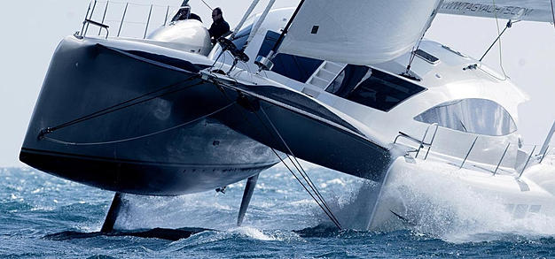

One rudder per hull still works if you are flying a hull - OK not many cruising cats do that but I know of one French cruiser-racer cat owner that did regularly for long periods, though not this one - http://static.wixstatic.com/media/2....jpg_srz_626_293_75_22_0.50_1.20_0.00_jpg_srz
After it finished several days ahead of us on a race that took us (42 ft monohull) 6 days, I consoled myself with the thought that they must have had a lonely wait for the rest of the fleet to arrive to party.
On more ordinary boats, the two hulls also offer a nice strong point to attach pintles....
I don't know about rudders, but centreboards on cats are said to be very inefficeint if they are surface piercing instead of being in the hulls.
I'm sure central rudders have been tried and rejected in racing cats, but racing cats will fly a hull, they really operate as a monohull most of the time.
