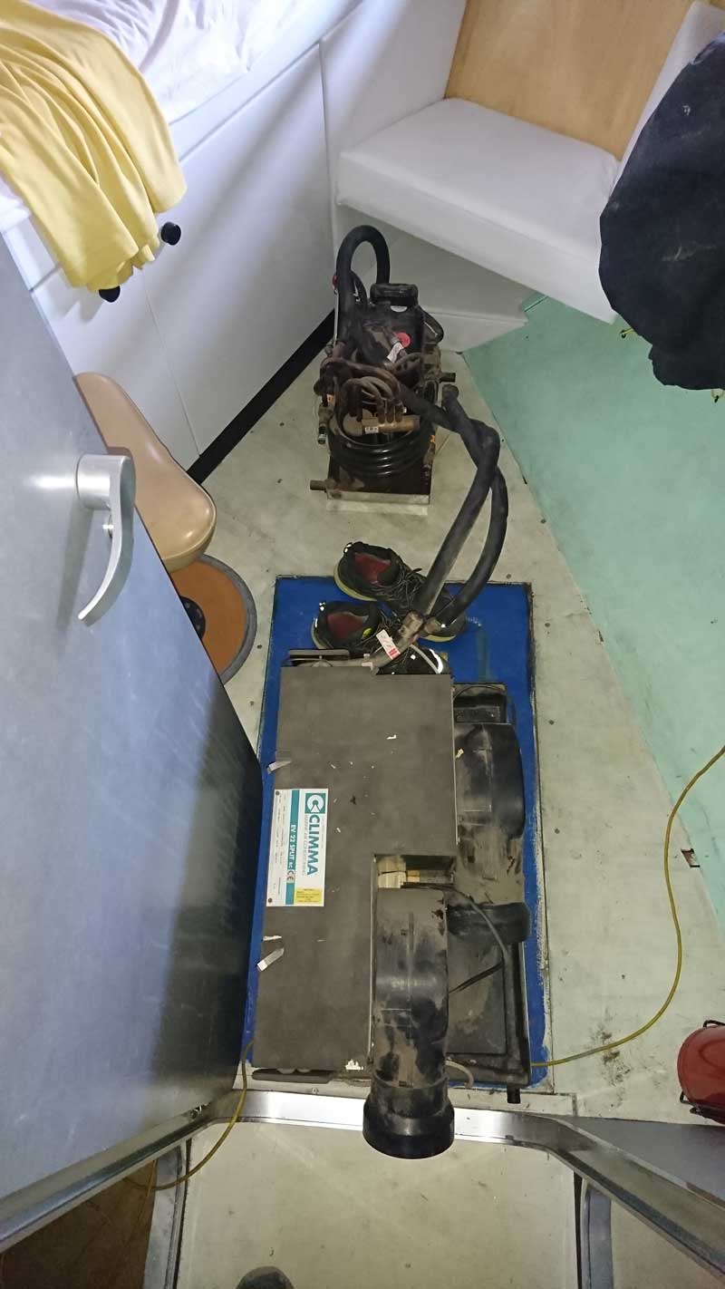

trying to tidy up things and reclaim some storage space where I relocated the aircon due to the stab fitting. So this is the reverse cycle thing which features two individual fans off the same matrix (That's how I see it at least!) leading to two 125mm dia pipes:
for what it's worth it's a CLIMMA Split 24 MK3 (that's 24k btu)
and it's now under the lower helm floor with the pipework coming at a handy hatch next to the helm seat and at the moment taking most of the space for no reason.
Pump lives below next to the stbrd fin stab.

Tbo Vas is it really that “ split “ in the sense of the distance from the compressor circled in red to the air handler circled in blue .If I have understood your pic ?

compressor uses some type of Freon gas that goes from the bilges to the air handler unit.

Arhh , it’s a self contained unit with one pump ( seawater ) to the cool the comp .Hence the short freon pipework .
Sorry Vas the nomenclature- “ split “ I took as seperate chiller with piped cold water to air handler(s) .
You mean the comp and air handler are not on the same chassis,presume for packaging reasons ? I would describe that as a self contained unit .

Given their are two fans I would imagine it is at least possible the fans are individually controlled?
If so I would not mix them in a single plenum as if the fan were off you are going to loose air.
You may also have issues if they dont both produce the same pressure.
I would split them, with each fan cooling a similar ish sized volume of air.
The return air is important in as much as the fans must have a supply of air in order to blow.
Ideally of course it comes form the same space it has just cooled, but if not you will still need to make sure there is sufficient air "leakage" generally to the area concerned to feed the fans lots of air.
The unit is a reverse cycle AC system with seawater cooled condenser (round black coil) and air DX cooling evaporator coil. The reversing valve sits inside the water cooled coil.
The pipe run is quite short. I expect R407C or possibly if pre 2000 R22. I doubt it is R410A especially with flared connections on the inter-connecting pipes. Could also be R417A or R422D. If it is R134a it will be quite gutless. If it is R12 it is well past its use by date !
No reason why the two fans can't be feeding separate areas with separate controllers / stats, but a return air is essential from each zone,
If you have to dismantle the pipework I would consider getting rid of the reversing valve and make it cooling only, but this will require some brazing and then normal fridge procedures to re-charge.

So, just in case, I'll do one fan two cabins, second fan galley/salon and make sure I can draw air from all these spaces. At some point later I may have a go at sorting out varying fan speed for the two sets.
