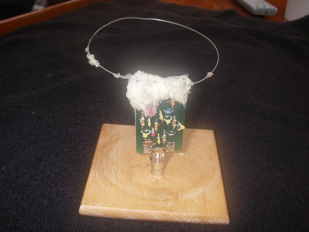

It depends on the reception in your area. The Glomex antenna (and I know because i have taken it apart) consists of a loop of wire inside a very nice housing with lots of foam!! There is also a small amplifier and perhaps some filtering. A smart move might be to buy a TV masthead amplifier from Maplin and use your own bit of bent wire.
