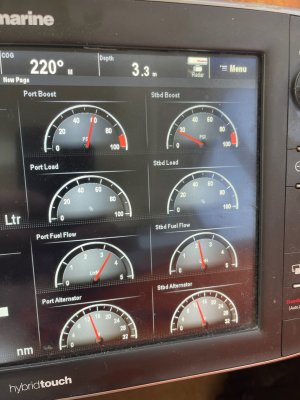

The port engine was reading a constant boost of 60psi - at the ECU not a dash gauge which uses a different sensor.
This means the ECU was overfueling on acceleration causing a puff of black smoke. And additional fuel use. It was all quite subtle and the engines were running well. I fitted a device to display ECU data on my chart plotter which alerted me to it.
Swapping parts showed the ECU was at fault.

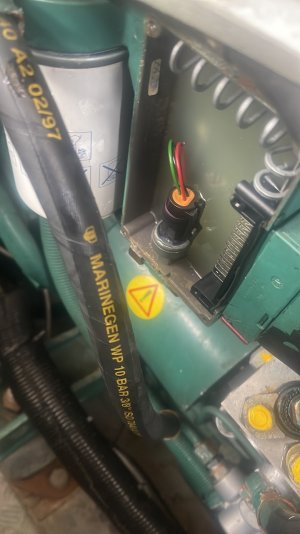

Egged on by various boaty mates, notably @vas and @petem i took the lid off the ECU with the aim of swapping the boost sensors.
I found this.
And it didn’t take a lot of hacking to get the boost sensor out.

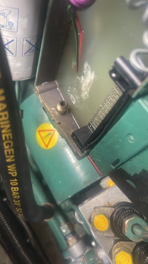

I found water in the pipes of both engines. There is a T under the ECU with a blank one end. Use this to drain the water.

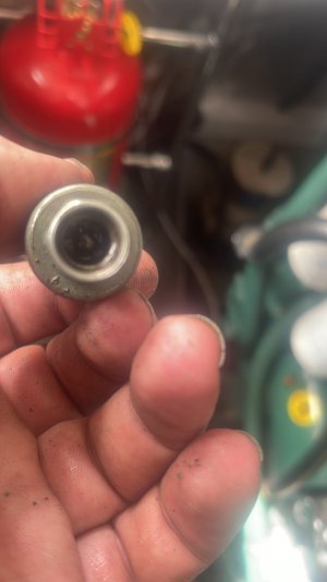

There was crud in the sensor. This is the good one.
I cleaned it out with contact cleaner.
Same port side and the idea was to swap them to isolate the fault.
However cleaning it out cured the problem.
A free fix for a rainy day. And I’ll remember to drain the T periodically in future.
Before.
After
