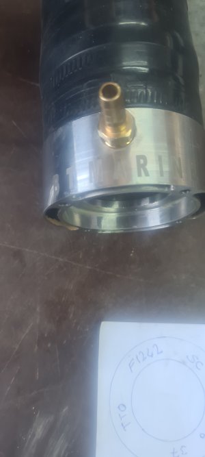

I have a leaky shaft seal and I need a replacement. The unit is branded BT Marine and i just need the internal seal which has dimensions 63 x 40 x10 mm. They're not available in Turkiye. Can anyone suggest a supplier in UK or Ireland or Germany 17213743224605106942175239080276.jpg20240719_093811.jpg

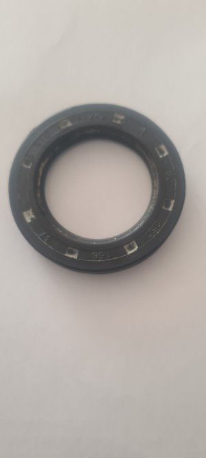

I would suggest getting the verniers out!
That seal has '250' printed on it.
2.50 imperial redneck inches is 63.5 of your filthy french mealy-meters, lots of 2.5 inch seals about.

Looking more closely I agree with you...
2.5" x 1.56" x 0.37" which is 63.5mm x 39.6mm x 9.4mm

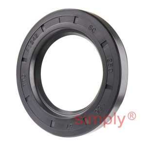

This one has the same 250, 156 & 37 size markings as well as TTO, SC & F1242 as the original. It looks identical.
1.56x2.5x0.37 inch Nitrile Rubber Rotary Shaft Oil Seal with Garter Spring R21 / Simply Bearings Ltd
Thanks. So maybe that's why it was leaking, 39.62mm seal on a 40mm shaft. I know the boat had a small grounding incident a few years ago on charter which required the shaft to be removed, and the cutlass bearing to be replaced, so this may have been a question of fit whatever was readily available to get her back on charter. It's definitely not original which was Tidesmarine. Anyway, new one ordered and on the way.
