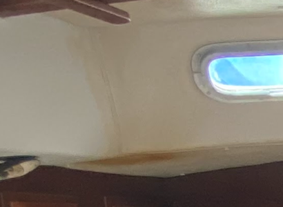

Hi Everyone,
I am seeking some help in relation to a Trident warrior 40, 1997 that i am looking to buy, so the vessel has a brand new Beta Marine 50hp engine fitted, new sail Drive, new propeller, new bow thruster and new electronics, new lithium batters, recently copper coated and antifouled, my main concern is the water ingress from the windows and hatches, i was made aware of this, and can live with this, its just a case of replacing the windows and hatches, of what i am willing to do, at least 4-5 hatches leaking and 3-4 windows.
My big question is! prior to me requesting a survey, is this an easy fix, or could there be delamination happening, if i am being honest i have no clue of the fabrication or structural integrity of these boats, due to my work commitments, i haven't viewed the boat, but the owner i believe is being honest with the information he has communicated, and the broker has been very forthcoming with photos and videos, and pretty much answered every question i put forward,
Top side, looks to be fine, i know standard rigging will need replacing at some point, and i am more than happy to bear the cost of this, providing the boat is free of osmosis and is structurally sound, i intend to liveaboard and travel the oceans, i know most of you will say, wait for survey results, but i am pinning my hopes that someone has encountered the same issues and could possibly assist/help with some advice, the owner has valid reasons for the sale, and i couldn't resist putting ga cheeky offer in, that was actually excepted.

Locating the point at which water is getting in can be a pain in the arse and must be done before you can start sorting the damage. The first few photos show that the entry point is not at the window but is higher. This is where your surveyor earns his fee.

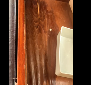

The last photo of the damaged shelf suggests the need for replacement. This is usually straightforward, but if you are not a ship's carpenter already, you soon will be.
The shelf and lining panel damage looks cosmetic and DIY fixable. But you (or your surveyor) need to establish the extent of any hidden damage and the cost to remedy if the wood is damaged beyond the veneer. If it really is every hatch and window then it could be significant. I would be especially interested in deck moisture readings and any signs of water in the deck core. And the condition of structural bulkheads.
Resealing hatches and windows is DIY. Replacing could rack up costs. Deck core repairs are more complicated, especially if balsa rather than foam. For the short term, insulating tape can be useful to stop leaks. Do not use silicone sealant! You are unlikely to get a meaningful estimate of costs unless you know what needs done.

And thank you for you assistance, as you mentioned, trying to find the source of the leaks is going to be a problem, port and starboard side, both have leaks in the same location, or should I say water staining in the same area, and the broker seems to think its from the hatches above, he also mentioned the current owner is in Italy and very rearly get to the boat, and the previous owners, they neglected it the last year of ownership, hopefully the moisture readings will not bring unfavourable news, the broker mentioned, they havent identified any soft spots on the coach roof or anywhere else.
