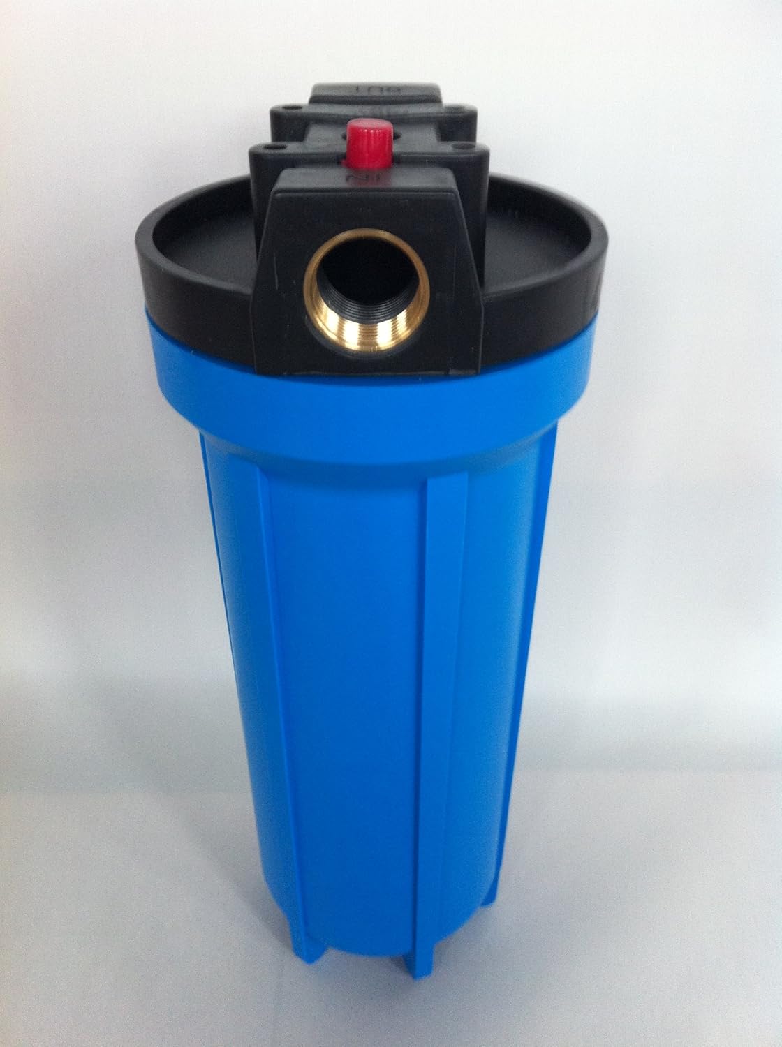

I had an inline filter with a 'burp' button on the top just before the watermaker.
Similar to this
Only had to use it in very boisterous conditions.
My inlet was 500mm ahead of my engine inlet so in a good position.
