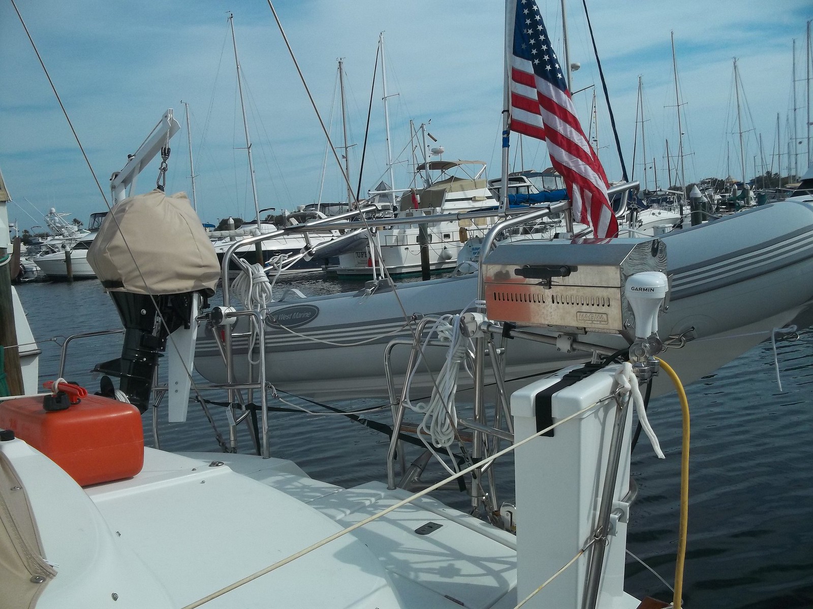

A purpose built and designed crane attached to the pushpit with a harness on the outboard using a 4 to 1 tackle makes life very easy, you set it up on the boat slacken the securing clamps ( mine used to live on a wooden block on the pushpit ) then get into the dinghy alongside lift the outboard of using the tackle and lower it onto the tender secure up the clamps undo the tackle ( snapshackle ) from the harness and the jobs done.
