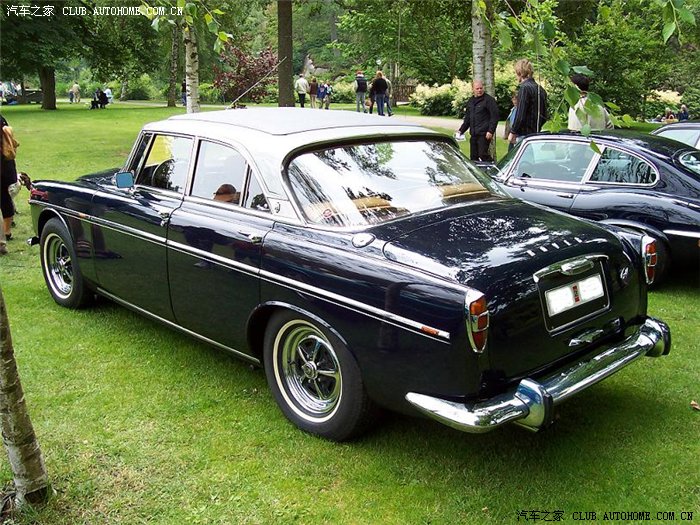

Rovers had leather gaiters on cars as recently as the P5
