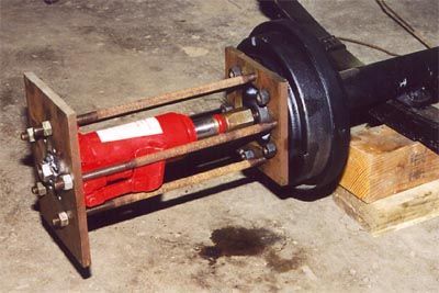

Or a homemade puller using a car jack

Just don't stand in line with the puller. A friend of mine left a hydraulic puller at full pressure overnight on a stuck rear hub once ... when he came back in the morning the puller and hub were lying about ten feet from the axle. Not something you want to be in the way of.
That is why an experienced bloke leaves the nut loose and flush on the stub axle when fitting and loading the puller on a tapered shaft.....................................
The OP's axle is, I believe a parallel one, so no issue there.
