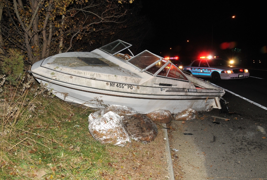

Peter, it seems to me the major issue has been ignored. How far and how frequently are you going to tow it? If a great distance and often then sensibly use a braked trailer. If only a short distance of a few miles over easy quiet roads for a one off journey then the risks are minimal and I think an unbraked trailer would suffice.
If you want to avoid situations like this I would stringly suggest not towing an 800Kg boat on an unbraked trailer
Apart from the possibility of plod stopping you an even a short journey.
