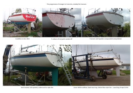

In places I used 180 grit due to lots of discoloured gel coat as the Ryland gel coat used is not UV stable. When I bought Concerto, she was trimmed in red including a red painted transom. When I suggested removing all the paint and compounding the transom, everyone said just paint it white. 4 days of work and everyone then said I had done the right thing, funny that they changed their minds. For those who have not seen the changes this composite photo shows the before, during and finished job.

Concerto just sanded, nothing else?
