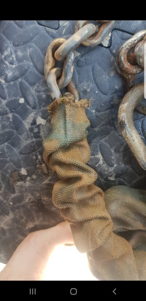

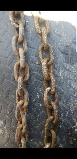

I had a sleave over my chain, and I was shocked to see the difference after 2 years of the section not in the sleave.
sleaved section still measures over 10mm, but the unsleaved chain is pitted and measures only 9.4mm.
I was told the sleave might cause the chain to rust more, but as you can see it offers better protection.

Galvanising on a chain in a mooring system will not last long. The constant mooving under load quickly wears galvanising between links and then starts wearing the chain metal itself. Galvanising might keep the outside of the chain looking good for longer but wear will be similar to black iron.
Interesting that OP chain is ok under cover. Cover is bad in one sense that you do not inspect the chain in that area. I can only suggest there is less movement of the chain in that area So less wear. Or worn chain is the part in the water more. . ol'will

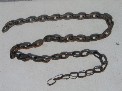

Indeed yes, moorings are a very different matter. Corrosive wear is a major problem, this occurs where a nascent bright surface is created by wear, either between links or against the seabed, it corrodes and the rust is immediately worn away. I know of a mooring in a rather exposed location in Menai Strait that had a boat on it all winter. The mooring failed in the spring and the boat was wrecked. I saw the chain but have no photos.
The photo shows a chain I saw in Mallorca, a mooring for a small motorboat. Wear occurred against the sandy seabed.

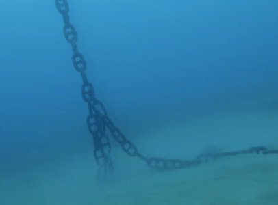

You're not kidding! Here's another photo; wear is especially bad in volcanic ash. I took the video on Good Friday (the pic is a still from the video), and on the evening of Easter Sunday the chain parted and the boat on the mooring was wrecked. I tried and failed to alert the boat's owner to the state of his riser over the w/e.
In the swell the riser was going up and down about 1m, and the wear in this section was amazing, whereas it was negligible elsewhere.
Depth ~14m, Boat 'Joyce' a 23m LOA fishing boat, location Little Bay, Montserrat. You can see where it was joined by a shackle in a futile attempt to bridge the worn section.
