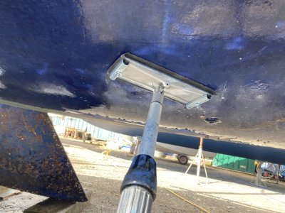

I wet sand every year. It prevents a build up of loose flakey paint. I use a dry wall pole sander with a gauze sanding material which comes in a roll. A hose with a gun, to wet the area to be done, and to wash off the slurry. The pole, with an articulated head, makes it easy, and keeps you out from under.

Use a drywall pole sander. There are other holders on this site
pole sander
I use wet & dry with it & a sprayer rather like a garden spray . That is used to spray an area with water for sanding.
The pads that you show are too much like hard work
I too use a pole sander but with sanding mesh, eg... 115mm x 5m Sanding Mesh, 120 Grit - Prodec Advance | CPC (farnell.com)
no clogging, readily washed with water
the combination works a treat (NormanS: Snap!)

Most people I know use a pole sander with mesh abrasive. Just have a bucket of water to dip and rinse now and then. The ProDec suggested above is OK.
In terms of bang-per-buck, I think the no-name mesh is better value than Mirka Abranet. My local hardware store actually stocks an unbranded range of grits at a sensible price.
