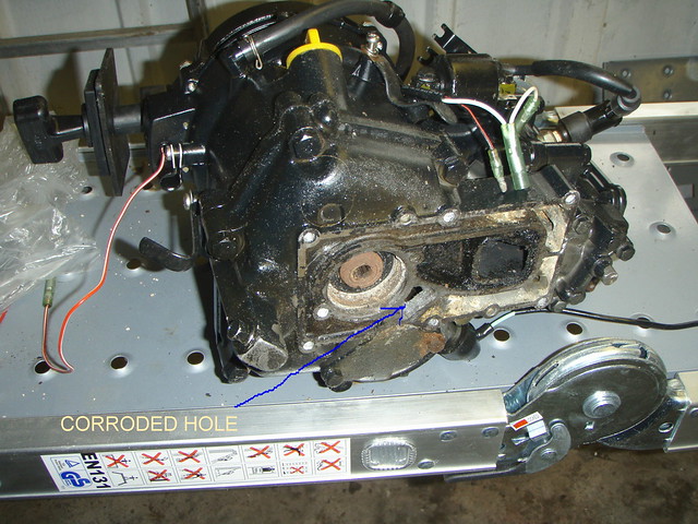

I once owned a 5HP 4 stroke Mariner same sort of design engine I think. It developed an oil leak and the red light came on I found out it had a corroded hole here is a pic:
Hope you don't have that problem:o all the best.

Salinia, was it easy to remove the power head (engine) in one piece from the casing like you've done in the picture showing the corroded hole? Have you attempted any repairs since the posting?

Having disassembled the power head, the oil pan shows exactly the same corroded hole as in your motor, salinia.
A new oil pan is around 235 USD... so now I'm considering methods to repair the corroded oil pan. Maybe welding is an idea. Or some chemical compound...

Managed to disasseble and clean oil pan and all associated parts. Cleaned around the corroded hole with spirits to get rid of all oil residue, and also heated the area for a few seconds to possibly get rid of any oil soaked into the porous "walls" of the corroded hole. Then I applied a chemical metal compound (the one that you mix together metal powder and fluid stuff). Reassembled the motor with a new set of gaskets, refilled 4-stroke oil and now it runs without any signs of leak. Hopefully this did the job, but time will tell...
