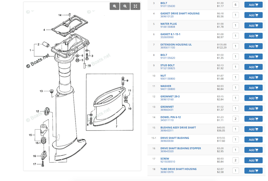

It's all a bit strange to me as I've had two stokes with fuel issues before and they usually bog down and then cut out where as this just cuts out with no warning at high rpm and it starts first our second pull and idles fine. Is there any chance this could be to do with the exhaust/backfire and the leg filling up with water? After taking of the lower unit it seems to be missing a couple of parts 15 - 16 in the attached image. Also there's quite a bit of oxidisation inside.

The parts, # 15 and 16, you mention are only fitted to the long and ultralong shaft models according to the official parts lists
