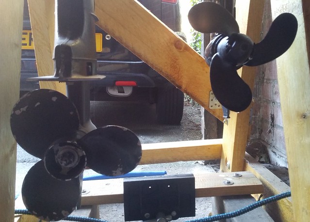

And, what's the best way to deal with this rusty bar that separates the bottom-end of the transom-grips? Just a new 316 bolt or bar?

I'm not sure I'd worry about that rusty bolt enough to replace it - the whole shaft of my outboard is like that. You should be able to find a parts catalogue for your engine (PDFs on the left hand side of this page or try this site) and once you have the part number you can google it - I'd replace it if it was cheap, but I think a stainless replacement would be expensive. Does it have a nut on the end, or is it screwed into aluminium?
The outboard bracket hinge and both clamp screws seized on mine over the course of a few months last winter, so I make sure to cover the screw threads with coppaslip (or non-copper grease as some forum members prefer) and exercise them once or twice a month when the engine is not in use.
I replaced mine with 6mm Stainless threaded bar available a a reasonable price from most engineering suppliers. Use SS Cap screws to finish it off . works fine.
I would rub down the bar and then give it the black hammerite treatment in situ
