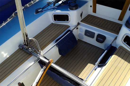

TekDek for me, self laid, Cockpit seats and sole, transom step 3 sections. ( The grating in the photo got replaced as well )
It has worked out well. Laid about 6 or 7 years ago now still looks good. Boat is left out in the Greek sun year round as the cover does not go over the cockpit.
Fiddly job to get right. Occasional eppisode with black caulking getting on hands etc. 'Next time' I'd make accurate templates and ask the company to make up mats to glue in place.
