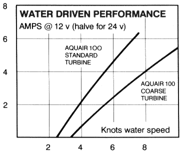

Aquair
One of the wind generator companies does just this thing. Trouble is, if you look at the figures you don't get much power at less than two knots:
