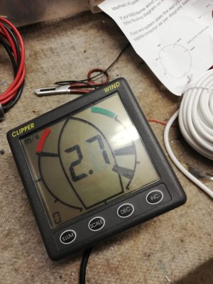

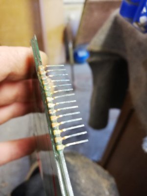

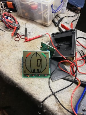

Through this forum I acquired a NASA masthead unit, with a broken readout (faulty screen) thrown in. Just to see if it was salvageable I opened it up and found water had damaged the electrodes

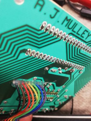

After a lot of farting around to get that out the wires onto the pcb sheared, so I resoldered them and added some support to prevent recurrence
Measured it all through and it seemed fine. Phonecall to NASA, who don't have a menu system but just answer the phone. Yes, they can supply the parts, just email some photos to confirm 100%. Done, £20 in parts, delivered the next day - today.
And it now works - I'm seriously chuffed, I hadn't budgeted for wind instruments till next year 😁
