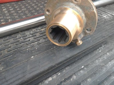

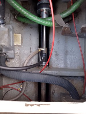

Another vote for machining the housing to take a standard cutless bearing. I have done this n 2 boats, the first was a Stuart Turner housing wwhich sounds similar to yours - same length and similar ID but a rubber lining . At the inboard end it had white metal and a "leaky) stuffing box so again machined the ID to take a cutless and the OD to take a Volvo seal. Did similar on the current boat changing from 1" shaft to 30mm and machining the inboard end to take a cutless as extra support for the rather long shaft. again OD to take a Radice seal.
