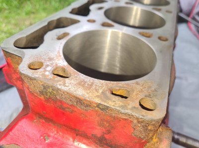

This is the block i had sent for a rebore and skim, being a VP AQ130 B20 block.

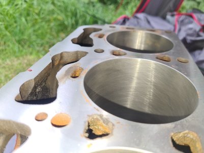

It came to me like this, rebore seems ok, i say `seems` as the head is not good IMO.
i am going to call the machine shop in te morning but i need to know if there is a max amount to be skimmed off these block before piston inteferance.

They were probably taking off the bare minimum just in case. I would not worry too much about the remaining rust pitting, a smear of Hylomar should ensure that you get a satisfactory seal.
The bore and honing looks good providing the size is correct.

As for the OP, I'd be questioning that skim, even if only to ask why they stopped there

Looking at the photo's I would certainly question the machine shop over the skim, it may be that they have skimmed the maximum safe amount, but at least it's worth checking. As others have said the bores look good.
I would not use the block in that condition. The suggestion of bodging it back together with Hylomar should be avoided at all costs.
The correct solution would be to skim the head properly and then to skim an appropriate amount from the tops of the pistons.
The skim would not be acceptable to me. If the compression ratio is raised too much by skimming the head correctly, would it be possible to use two head gaskets?

I called them and they said it was max they could do before scrapping the block. When i mentioned nothing was said to me before collection or why it was not skimmed first, apparently you have to rebore first then skim. Cant argue with that as i dont know if thats correct.
So as it is i can either use as is, or fill the low spots with JB Hi temp weld or Stag Wellseal Jointing Compound.

Ten thou off of the block/head interface, ten thou off the piston crown. The engine is already in bits-chucking the pistons in a big lathe and turning a bit off is a doodle.
Nothing special about Volvo pistons.
The one I pulled in bits a few years ago had the piston crown level with the block at TDC. It was the first time it had been stripped.
Have the block skimmed, measure the protusion, remove it.
Simples..........................................

Not what it's for. Not only does it have to withstand the heat, it may well have to withstand combustion pressures. You have the block stripped and bored, new pistons, why would you then bodge it with epoxy, it's madness.
If the engineering company think that block surface is OK, you need another engineering company.
