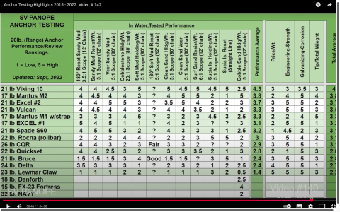

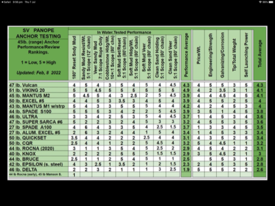

I'll introduce some controversy,
There are few new anchors being introduced to the market but to ignore Viking Anchors, the quality of which is (based on the Panope spread sheets's results) is the best anchor tested under the Panope regime seems a perverse omission. Everyone knows of Rocna, Spade, Excel and Fortress. I might have thought individuals would be interested in the newest that's also the best - an independent review, independent of Panope, would be refreshing.
Aluminium anchors have no reputation of poor setting. Viking Anchors are roughly half their weight for their size, no mention, anywhere of poor setting.
Its not difficult to secure a model - they are instock, available for immediate delivery - in Belgium (unless they have sold out :( ).
I believe there were a series of posts on Sailing Anarchy suggesting that Steve Godwin aka Panope is coming out of retirement and is reviewing the new model, Odin, from Viking. There is no mention of when a comment from Steve will be available (and I don't have a link)
Odin uses the same fluke as the original Viking, the slot in the shank of Odin is in the same place as on Viking - my testing suggest that for hold they are indistinguishable. Odin is new and manages to be as good as the original Viking without the roll bar and has no ballast. Its uncanny in terms of its setting in sand - yet for its hold its half the weight of a similarly holding Spade, Excel, Rocna et al. Odin and the original Viking save weight simply because they take advantage of High Tensile steels - the complete anchors are made from HT steels - a fabrication move that no-one else has used. Being half the weight means it competes directly with other steel anchors and outperforms aluminium anchors like Spade and Excel (check the comparison of the aluminium Spade and Excel vs Viking on the 45lb spread sheet.
