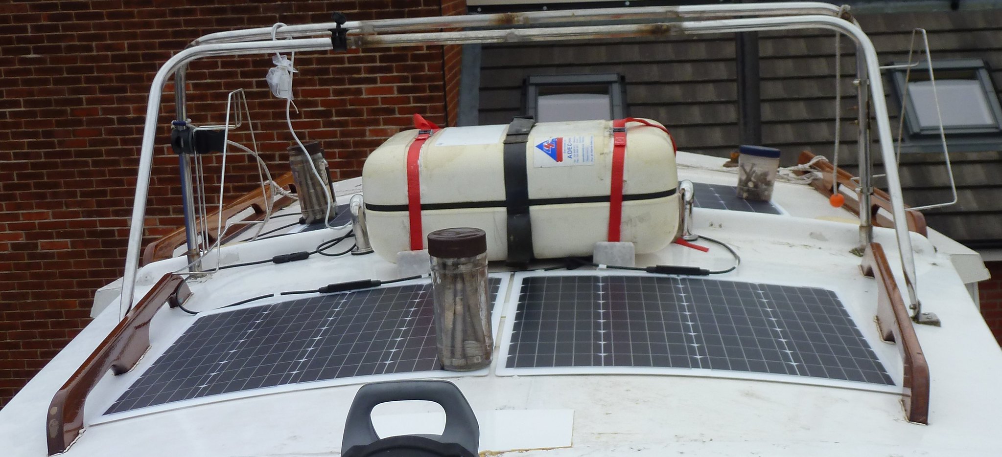

Polysuphide! I fitted three quite large semi flexible panels on the roof of the Mobo. Two at the front for 24v, one large single at the back for the 12v. It has stayed perfect. Just needed a little weight
solar panels ext by Roger Gaspar, on Flickr
That was done 3 years ago. The Polysulphide beads could provide the required 2mm air gap underneath that was recommended and holds the panels without any problem. Polysuphide has the advantage of being removable if ever needed. It seems to me people have forgot about Polysuphide. chandleries just stock CT1 and Sikaflex 291 because of all the nonsense about it.
