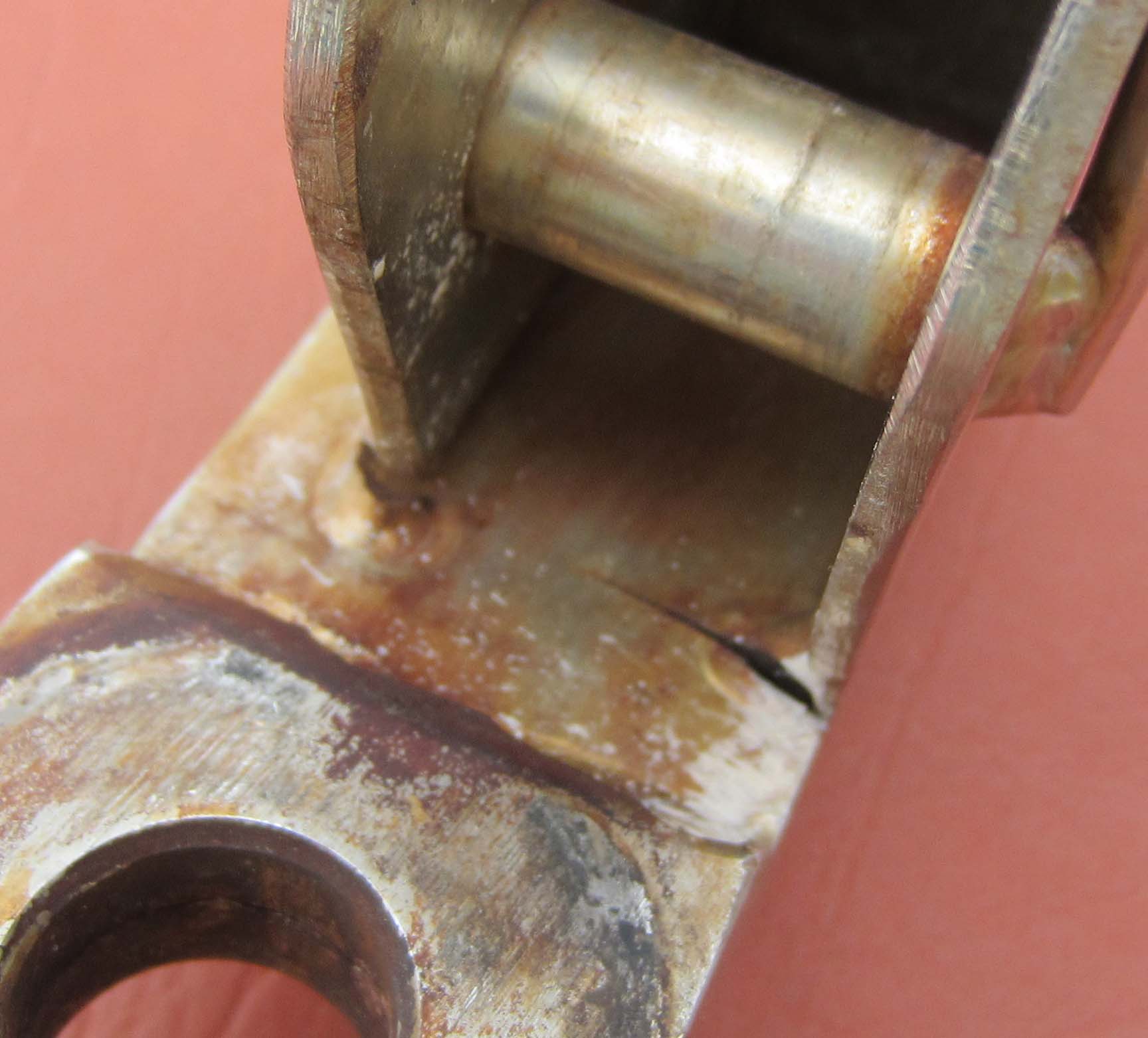

Correct; a friend with the same boat had the tang (not sure of the proper term but the bow equivalent of a chain plate) to which the forestay is attached, break off, narrowly avoiding losing his mast. Some research on the owners association site and that for similar models shows this is not an isolated problem. It is difficult to inspect for cracks because it is enclosed, the furler drum is above it and the fittings, clevis pins etc obscure the area where the crack is likely to be.
A photo of the sheared off surface, which shows rust stains near a part where another gusset plate is welded to it indicates that some small imperfection has probably been the start point for crevice corrosion which has progressed over years with the crack developing until the remaining cross sectional area could no longer take the load.
So to inspect mine I need to be able to slacken the forestay enough to remove the end that fits to the deck and have a good look. There may or may not be a crack there and if its only small a weld repair may be possible in situ. But until I inspect it I can't tell!

This is the part on a similar model - so no - i don't want to use halyards attached to that :-)
