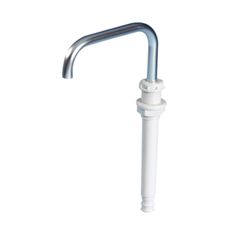

One of these?
Whale Telescopic Faucet Std White

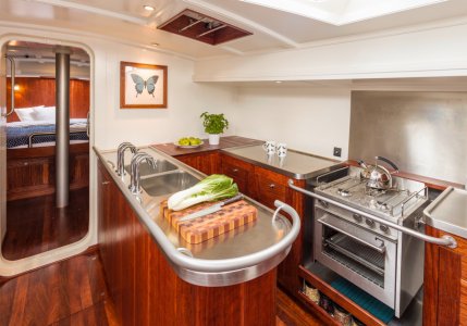

We use a standard stainless steel household spout with our Whale foot pump. It is better quality and sturdier than most "marine" alternatives.
They (we have 4 identical spouts) can be seen in the photo below:
That’s a lovely looking boat, and a long way from the interior of the Foxcub/ Foxterrier/ Foxhound series of boats owned the OP and myself. I wish I had space to fit 4 spouts. Your two basins are the size of the entire galley in the bigger Foxhound

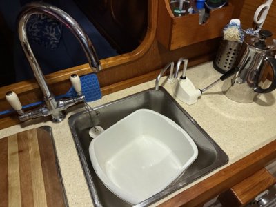

If we’re into galley sink sharing. We have a mixture.
Left to right
Domestic minoblock mixer tap off the pressurised system. (But can be operated off a foot pump in extremis)
Outlet for watermaker to test water prior to allowing it to deliver to tanks
Sea water hand pump for supplying sea watef for rinsing dishes/vegetables etc etc.
The outlet for the watermaker can be moved up and down and side to side.
