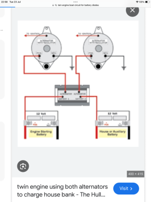

As an aside...I wonder if the diode arrangement is working? perhaps I only have one battery in use starting?
Good point
The diode is to stop your fully charged ‘cranking’ battery draining into your auxiliary battery when it’s a bit low. My guess is that you only have one cranking battery for both engines and that your diode is probably working OK

my understanding of the diodes is that they do indeed protect the starter battery from doing anything but current to starter motors. This means the domestic pair can supply the starters, meaning in effect there are three batteries can start the engines but one is protected from domestic drain?? is that correct then?
In a word….no
The Diode only allows current to flow one way. From the alternator to the battery or batteries so one alternator can charge multiple batteries . When starting…the diode would stop current being drawn from the domestic batteries in the same way it stops current being drawn from the starter battery to domestic systems
Sometimes there is a joining switch to tie all batteries together for emergency starting which by passes the diode in effect
