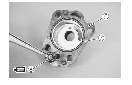

So finally I got around to actually doing the Suzuki 2.5 service. It's close to 8 years old but probably not done 100hrs. I do change the oils and run fresh water through it each year. This year my particular goal was to change the impeller which I have done. I wonder why in retrospect since it was very hard to see the difference from a new one.
While the leg was disconnected from the top end I changed first the gear oil and then the impeller. When I came to reassemble it I briefly held the leg upside down and oil started running out through the hole where the gear engage rod goes. My QUESTION, is this normal? Am I missing something? A secondary question. While the leg was disconnected, with the new impeller in place, turning the propeller by hand had a 'grainy' feeling to it. I can't see why since the blades do not actually have to compress. Again, normal?
There should be an O ring seal around the shift rod where it enters the gearcase.
The propeller should turn smoothly. The grainy feeling is probably due to a rough bearing. Perhaps water has entered the gearcase and caused corrosion of the bearing.. Maybe new seals are needed.
You can see exploded parts diagrams at Browns Point Marine Service, LLC - Suzuki Parts Lookup

Vic, thanks. How is that o-ring retained? I presume it is part #09280-06004. Without the shift rod in place does it make sense the oil falls out if inverted? Also can the o-ring fall out? I will have to disassemble to see if it is there. I don't believe I have lost it. Could it be the shift rod slides smoothly past it on reassembly?
The old oil looked clean and it's little used so I am surprised if it's a bearing issue giving rise to the grainy feeling. Thanks again.
