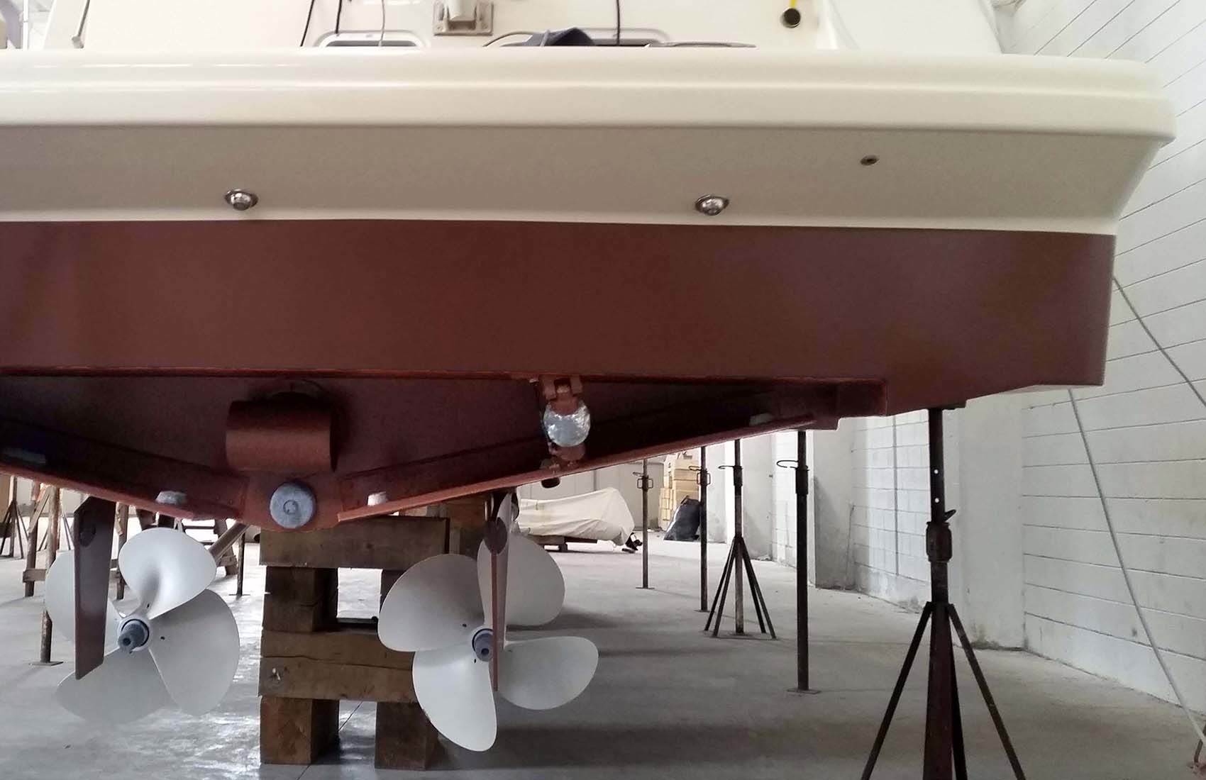

My boat had three of those lights retrofitted by her previous owner - see below (the third obviously being on port side, symmetrical with the stbd one).
Cost saving aside, I can see his train of thought, because the reverse slanted tip of the swim platform allowed a placement somewhat hidden, and just above the w/line.
So, if you're happy with that type of lighting, it would be hard to find a better placement.
In spite of that, one of them wasn't working when I bought the boat, and another failed shortly afterwards.
So, being a big fan of the principle that the only stuff that never break on a boat is what you don't have, when my yard made some colour matching gelcoat for a tiny patch on the swim platform corner (don't ask...!), I told them to strip the things and get rid of them - end of the story.
Each to their own, as I said!
