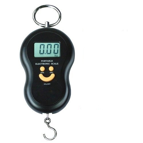

i bought some digital scales on ebay. the type that can be hung on nail with a hook, then zero with a basket or similar containing the mixing pot, then weigh the 2 parts, scales were £3 delivered
http://www.ebay.co.uk/itm/0-01Gx40K...781?pt=LH_DefaultDomain_3&hash=item51c126e57d

I use a kitchen scale (no smiley face..) that is good to a gram. Cost a bit more than £3
