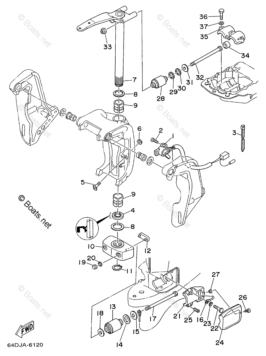

I think you may have to dismantle the steering swivel, clean and regressed the bushes. Parts #9 in this diagram
https://cdn.boats.net/cdn-cgi/image/quality=50/MTA/d/6/MjE3NDY0-6bd530be.png
Looks like a big job if I'm right

I agree with Vic big job but from the diagram that is what you will have to do. Good luck.
If you do whilst it is in bits i think I would be drilling and fitting two grease nipples at suitable points on the tube to prevent a reoccurance.
