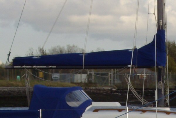

My stiffeners (ooh er missus!:)) are about 10mm fibreglass rod. No bending from suspension points. A bit longer than yours but not much.
When I had mine made I specified that the lazyjacks should tie directly to the stiffeners so that there were no eyes or loops involved in the suspension. A small cutout in the pack at each suspension point suffices. Now in it's 6th year and no repairs necessary yet, although the zip will probably need replacing next year.
Mine has the long sail battens.
Make sure that the zip along the top of the cover has a flap over it to keep the sun off - it is the UV that destroys the zips.
When I made mine I bought 10mm fibreglass rods, I think from the same place I got the long zip from- can't remember who now though! I was given a few tips at the time, including making a flap for the zip and not having the top of the 'box' too big/broad, so it doesn't collect rainwater. Mine looks identical to alahol2's, except I tied the lazyjack lines to rings slipped over the rods, because I found the rods shed tiny particles of glass onto my hands when handling them, and I didn't want bits of glass in the lines. I put a strip of 1000mm wide dacron tape at the bottom to slide easily into the groove in the boom; the only thing I would do differently another time is make it slightly bigger (it's a bit tight, hard to do the zip up- but that's because I was very short on material cos I managed to use the old mainsail cover for the canvas).
When I had mine made I specified that the lazy jacks should tie directly to the stiffeners so that there were no eyes or loops involved in the suspension.
Definitely the preferred method. I used webbing for mine which is a mistake as apparently it's much less UV resistant than acrylic canvas.
Having said that mine must be 5 years old.
I used 1" plastic waste pipe but it's a bit floppy...
