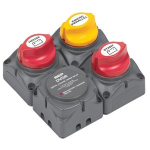

If you tried to use that to start most boat engines with a dead starter battery it would immediately blow the fuses protecting it.
Might get lucky if the engine battery was just a bit weak.
If your going to do it might as well do it properly with an isolator switch rated for the current and wired with the same size cable as feeding the starter motor.

Possibly, but boats are a bit different to a caravan in terms of risk if things go wrong.
If you had a totally dead starter battery even on a 19 foot boat, 80amps ain’t gonna be enough to spin the starter motor and start it from cold. Looking on eBay most of the fuses supplies with the kits are only 60A.
If a jobs worth doing it’s worth doing properly…
