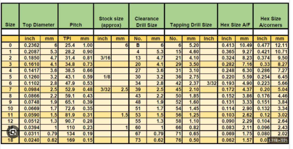

What is A OBA?

Zero BA, an Olde World size
Only those of us who had to deal with all these different threads and spanner sizes know! Olde World describes it perfectly.
My 1930 Rudge motorbike had 9mm across flats nuts holding the cylinder down. 5/16 X 26 cycle thread but much reduced diameter nuts because of reduced clearance to the cylinder side. Good thing there were plenty of them!
Not sure that i still have any BA spanners, i do have some Whitworth ones though.
