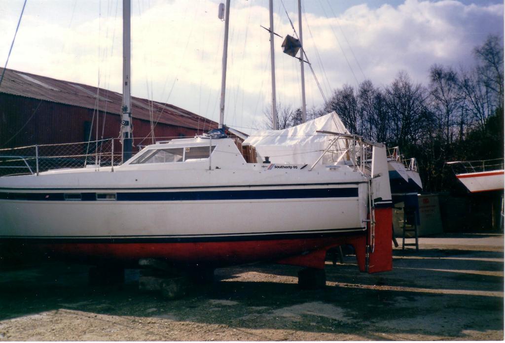

Sliding rudder
Any S95 will have a sliding rudder (unless an owner did a very silly major bodge)
S105 had this initially, I think later models (MkII) went to something similar to small fixed rudder on S100.
Only the older boats will have this feature. Later ones will be fixed and more modern models have twin rudders.
I was always pretty happy with the way she sailed. Not a racing boat (unless you are smoking something strange). I remember overhauling an Island Packet 38 of N.Ireland once. They are also pretty slow but I could see he wasn't too pleased.
She went better than expected in F3-4. In fact, I entered the cruising category for the local regatta a few weeks after my first sail. I had no clue about handicap, described her as a motorsailer and was given a generous handicap. I should have sandbagged a bit. The race officer came over after the race and said it was the first time ever that he'd re-handicapped a boat twice during the same race. Not certain how legal that was as I didn't race but he said I'd have won by a truly staggering margin on the original handicap. :D:D
Picture of my old S95 taken in 1985 and showing the rudder in raised position.
Why not use a rudder with a pivoting blade?
I'm guessing it was a matter of scale. I could just lift an S95 rudder after removing it from the stern. I couldn't considered lifting anything larger. The forces involved would be a lot higher than those from a small dinghy rudder. The sliding design was strong enough when fully lowered and most of it was out of the water when raised and subject to little drag. I remember the S95 rudder being close to 2m tall.
