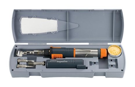

But the best iron I have is a gas powered one .. I can solder out on deck ... big / small / electronics .. etc .... it has a whole raft of different heads including Hot Knife that cuts and seals ropes !!
Once you've used one .. reckon it will be the only one you'll ever use !!
I bought the Eviron Set .... about 50 quid all in ...
Like Refeuler above .. soldering within a randome, whilst up a mast, the gas powered soldering iron was the only type that had any chance of working.
My longest lived/used/ favourite is the Gascat 75P.
As Refueler says, it comes with a couple of soldering tips, a very useful hot knife tip, a hot air tip and a small blow torch tip, all of which have been well used.
I actually got a second, to keep with the rope tools, in order to have one with a permanent knife tip fitted.
I do have others, but the other nice gascat feature is the spark generator in the cap with which to light it.. It's a bit like the sparky top on a small cigarette lighter.
You might wonder what the hot air tip could be used for... I have successfully used them for surface mount chip replacement in mobile phones.
To sum up... Very versatile... and you will wonder how you ever did without one... Oh and they have easily variable temperature control..
They even get used at home in preference to plugging in the desk based soldering station.
And as the OP mentioned... if the tip is way too hot, the flux will probably evaporate instantly, and thus be useless, hence the need for quick and easy temperature control.

I now have a 90W pencil type (obsolete brand) and a gas (Iroda) one - both are excellent. I tend to use the electric one for boat work as the gas one is a bit awkward to put down - it gives off heat sideways.
I was given a Dremel gas one - complete junk. Likewise pistol types - I've never got them to work for me (which reminds me, I have two I must throw away!)

My mistake.. It's my Iroda Solderpro 50K that has the cigarette lighter style flint within the lid.
The Gascat has a slide clicker in the handle.
Neither is favourite.. They are both great.

Had to sand the tip of my Gascat quite aggressively before solder would stick to it.
