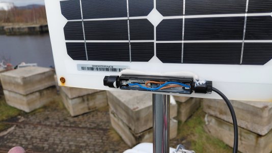

The cover keep blowing off my solar panel junction boxes anyone know of a source of spares.
You could fill it with electrical gel or silicone then cover with a slit section of hosepipe so if you ever did need to take it apart, you could dig it back out?
Yes silicon sealer would work but make sure you get RTV silicon that is suitable for electrical wiring as many set with a strong acetic acid which can corrode wiring. ie not plumber's silicon ol'will
