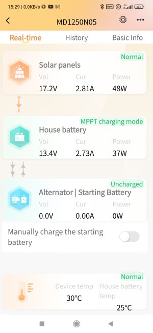

That is a very nice display, but why is solar panel voltage so low? Even on a cloudy morning the Vmp should be 17V+ for a typical "12V panel" unless it is very hot.
The other interesting point is the display suggests the MPPT controller performing the voltage conversion so efficiently that even after also allowing for its self consumption the loss between input and output is less than 1W.
The reality is MPPT controllers, while efficient, have more significant losses than the display is indicating.
Many manufacturers calibrate their controllers in this way to exaggerate the efficiency. On occasions, some will even indicate a higher wattage output than the input. A perpetual energy machine :).
You're probably right—on a sunny day, the V values are often around 17–20, and the signal-to-noise ratio isn't as good as it was when the screenshot was taken. Today it's cloudy and raining lightly—here's a new screenshot
That looks much better.

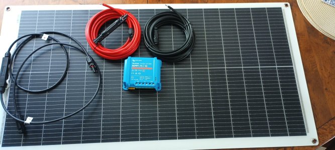

Right chaps, here's what I have - panel, MPPT, cabling and inline 15a fuse. Anything else I need before plumbing it in do you think?
I see you also asked this on the Victron forum.
Nothing wrong with doing so, of course. Many of the answers on there are completely nonsense.
