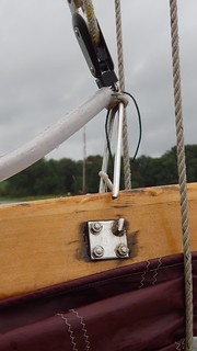

13.The stainless steel yard bracket that attaches the main halliard is not man enough for the job-if it fails you will be left with the halliard stuck at the mast top.Replace with something using 10mm stainless bar instead of 4mm,and increase the welding area. It is good to put a lashing from the halliard block around the yard itself so that if the fitting does fail,you can retrieve the halliard.
Seconded!
I just crossed the North Sea in my Coromandel https://tammynorie.wordpress.com/2015/08/31/landfall/
Then noticed this.
There's some discussion in the comments at https://tammynorie.wordpress.com/2015/08/31/whats-wrong-with-this-picture/
The rest of the OP's list corresponds very closely with that I've observed after two years with my Coromandel thinking about the Jester Challenge. I've only just found this thread, and it's great to have some confirmation as well as a few things I've missed.
