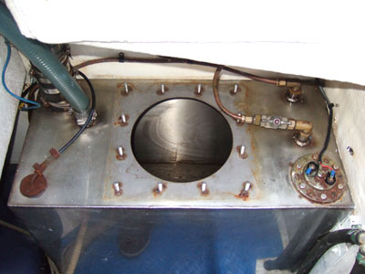

In my case the cause of the problem was traced back to a missing rubber o-ring on the deck filler seal. It had allowed sufficient water into the tank to allow the black gel to form at the bottom of the tank. I used the opportunity to cut an inspection hole in the top of the tank so that I can check it regularly and, if I ever need to clean the tank again, I can do so easily.

Mine comes out every three years for a steam clean.

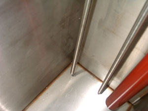

Geoff, sadly my experience of building and then using a home brew filter system wasn't great. The problem is the contamination on the sides of the tanks had the look and consistency of marmite, the sludge on the bottom of the tank thick cut marmalade which I used a 2" wallpaper scraper to remove. Using a filtering system didn't do anything to remove these, only opening up the tank and cleaning by hand was effective.

If you can access the tank one of those absorbent multi strand floor mops works wonders whether diesel water or sludge.

I use my small pump on my own tank annually. I get somewhere between 100 and 500ml of diesel that I have to dispose of, with sludge and muck in it, and then it runs clean.
It surely doesn't clean down the walls of the 43 year old stainless tank, but I have only once had a fuel filter block with that black gunk. In that case the boat movement was so violent as to risk structural failure - got caught in some very heavy weather. That was before I started annual "vacuum cleaning".
Of course it is always better to take off the hatch and fully clean the tank, but that can't be done every year without major hassle.
