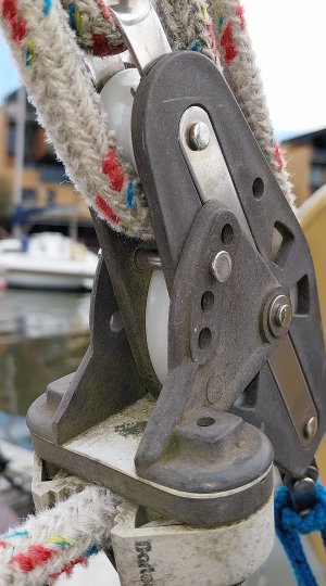

Thanks for all the advice. Badly worn as you can see but grooves filed in and back in action for now at least.20240401_123946.jpg

Hole spacing is 42mm but Im sure a bit of adapting could be done to make it fit.Cheers.
