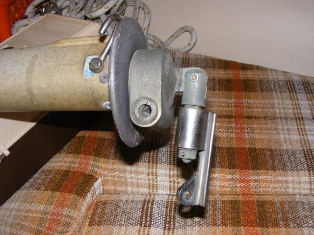

Please will someone explain to me why slab reefing is better than boom roller reefing.
I have exactly the same boom fittings as shown in the VicS pictures. My boat is a 26ft Heavenly Twins catamaran. The system seems to work perfectly adequately. I only do general cruising type sailing. Nothing fancy and usually single-handed.

The main objection to traditional roller reefing is that you cannot use the kicking strap once you have the sail wrapped around the boom, unless you use some fancy device. There are also issues with sail shape - the back of the boom tends to droop. It is more apparent on a large mainsail.
dmmbruce,
the big problem with roller reefing, be it main or foresail, is that it doesn't allow for the shape of sails; it would work perfectly if sails were completely 2 dimensional, flat as a sheet of paper.
As sails are hopefully shaped, the shape when reefed is baggy just when one needs a flat sail in strong winds.
In the past people used tricks like rolling sailbags and / or clothes up in the bunt of the sail to try and take out some of the bagginess, in the same manner as foam luffs on some foresails try to do nowadays; there were lots of stories of people putting the whole sail back up in calmer conditions and seeing their rolled up stuff fall over the side...
A reefing claw is also required to allow use of a kicking strap with the sail rolled around the boom, and the boom usually droops at the outboard end, a pain at least and quite possibly dangerous.
Slab reefing gives far more control of sail shape - the boom end blocks for reef clews should pull aft as well as down to give a flat sail.
Slab also allows the normal kicker to be retained, and the reefing lines, halliard & topping lift can be led aft which is a more attractive idea in lumpy seas than standing winding a gizmo on the mast.
So if one has to put it in one phrase, sail shape.
